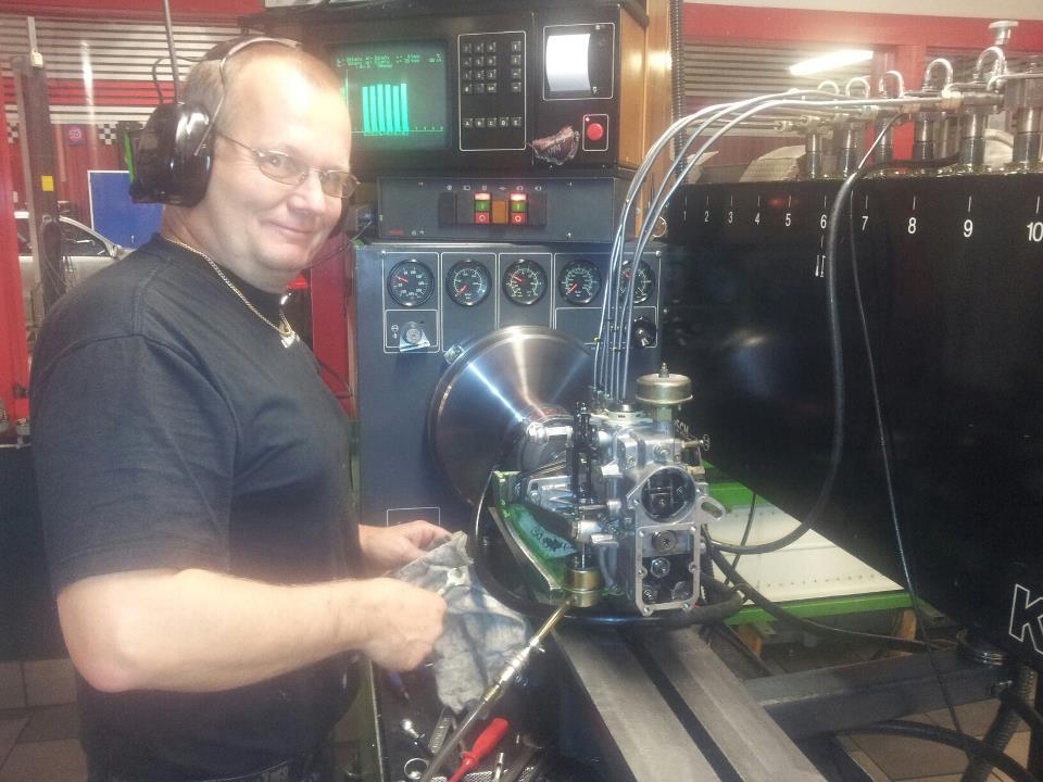

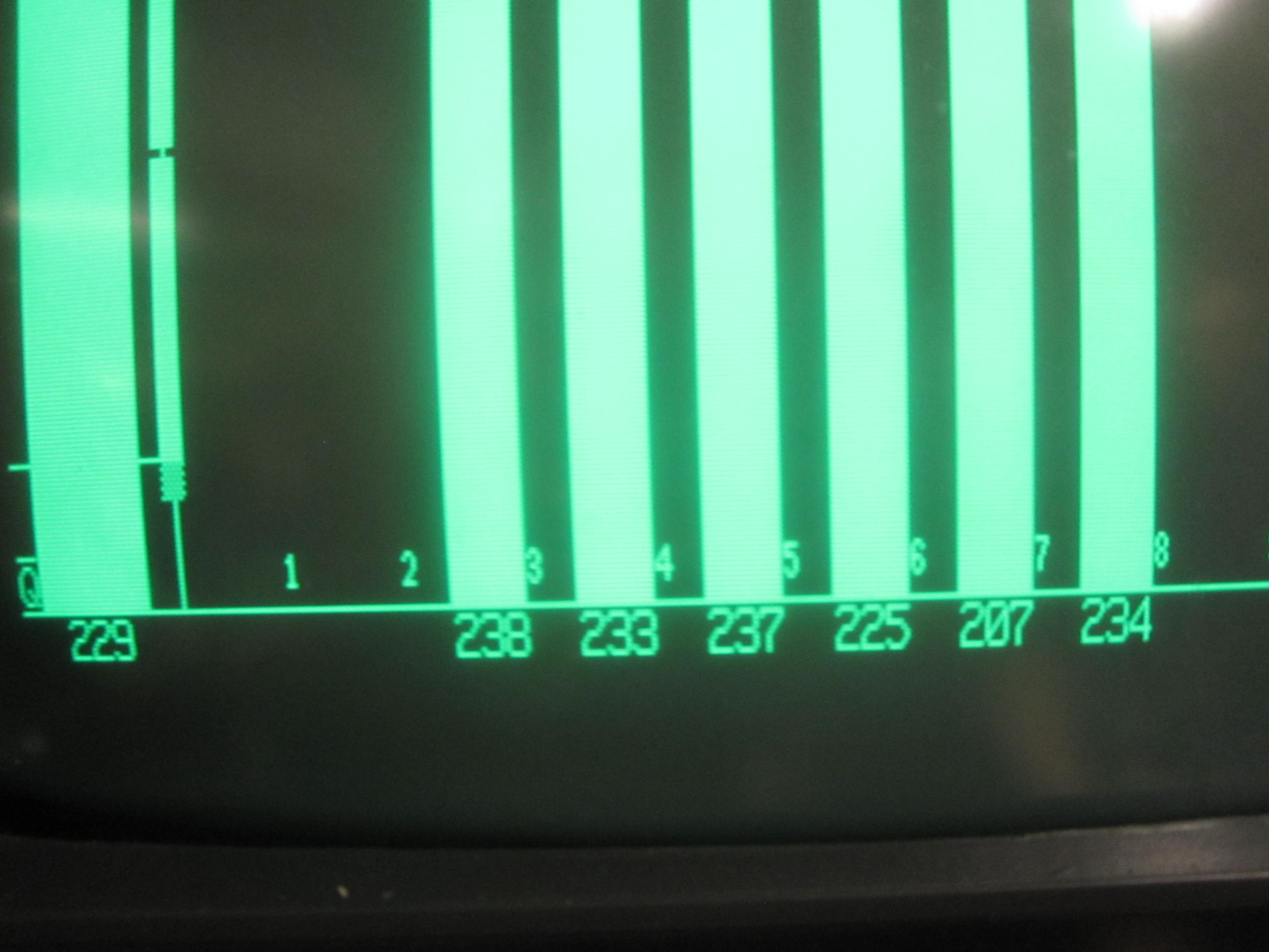

GTG At dieselmeken workshop today 20121110
http://www.facebook.com/dieselmeken#!/me...341&type=1
Development goes on, this is phase 2, 7,5mm performance maxed out
OBS Element on cyl 5 was changed, bad quality.
One glad dieseltech.
One 7,5mm testpump, this one goes up in dyno soon. Result will be shown.
