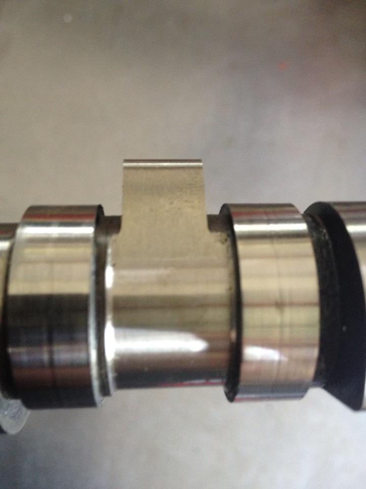

dieselmeken
407
06-12-2013, 01:46 PM #375
Here it is, first picture of the 8 mm camshaft for OM606 pump. This one gives 1 mm longer lift, I need to have a bigger roller also, Rollers comes from 14,40mm to 16,10.
Normal is 15-15,6mm in pumps.
I have some 17 mm rollers from Bosch A-serie that can be modified, but then the roller house needs to be grinded out a bit = weaker roller, no good.
Rollers are in different diameters for adjusting the phasing degree between the lines.
0-60-120-180-240-300 +- 0,5 degree
Tests will be made this summer, I have grinded 3 shafts for 6 cyl pumps.
Maybee a "monsterpump" soon comes to life?

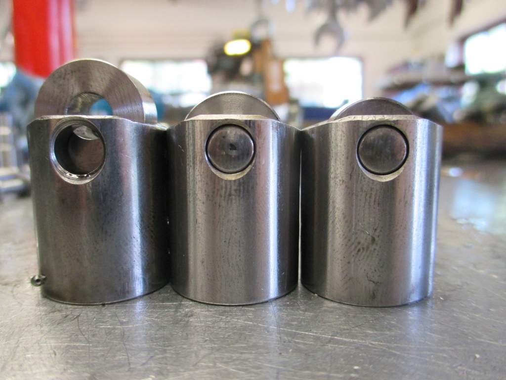

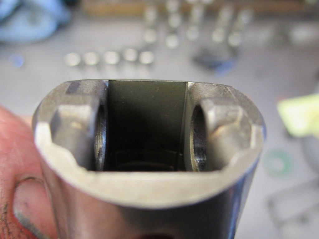

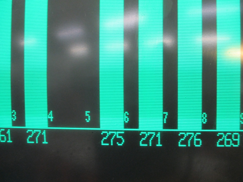

When 17 mm roller should go into the lifter, there was not space enough,
Here you can see the lifter when its done with Wire EDM
From left, 17 mm roller in stock lifter
17 mm roller in wire EDM lifter
15 mm STD roller
With the stroked camshaft I got 275cc of fuel at max racktravel
To note is that the inlet port in the element is 3 mm, Pre stroke is 1,3mm, stroke is 18 degree "long" (4,2mm lift on element) after that the inlet port opens up in the bottom and element goes further 2,5mm to stop injection
To get 275cc on only 18 degree ( 36 engine degree) is quite quick, my old notes told me that a stock 6 mm element gives 83cc on 18 degree
7,5mm 150cc.
If I got a twin inletport and maybee only 1,5 mm hole, (1,5x2) then the pumpstroke would be 1 mm moore, Theroetical that would give me 40-50 cc moore and then the 300cc barrier is broken.
NOTE This is only in theorie, but I am tempted to try it out on a set of elements.
